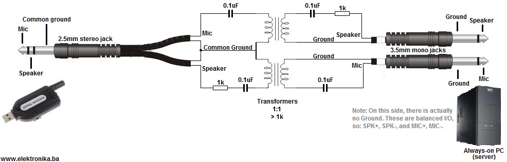

For this to work you will need USB GSM/GPRS modem with your SIM card connected to your home PC (with Windows) that will stay "on" during your travel. On that PC (we will call it server) you need to set up Skype with an additional Skype name (you can create another one like "my_skype_name_SERVER"). Then you need to start & configure the Skype Divert application that you can download from this page (red download button bellow). If you don't have it yet, go to Dealextreme and purchase this cheap GSM/GPRS USB modem GSM/GPRS USB modem. This modem was used during development and is the only one tested so far. You will also need a simple audio cable to route voice output of GSM/GPRS modem to sound card's input and vice versa. There are two version of this cable that you can make: one with the isolation transformers and one without them. Here is shown only isolated version of cable. (I used the first two transformers that I could get my hands on, and it all works just great.)
insert-cable-diagram
Schematics of audio cable (click on picture to enlarge)

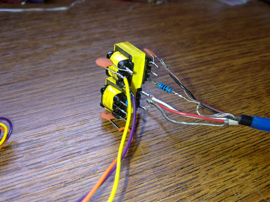

Quick and dirty cable

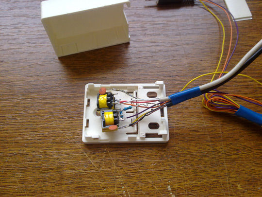

I also found a case for it :-)

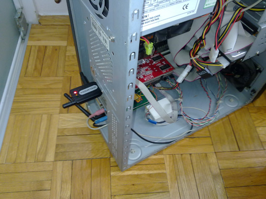

My server configuration (aka Skype GSM gateway)

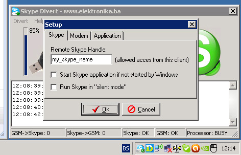

Skype related setup
In the text-box enter your original Skype name so that the server can recognize only your chat commands (instructions). If your Skype doesn't start automatically, you can click the first check-box. Skype can run in "silent mode" where it doesn't popup chat window, call progress window and notifications while Skype Divert is working. This option can be selected if the server is actually a PC that is being used daily as a normal PC.

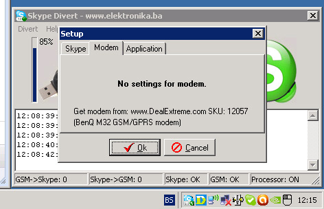

Next tab are modem settings and as you can see there is nothing to set there. All modem settings are read from Registry by the application.
skypescreen3
Modem settings

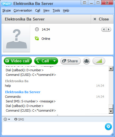

Now that we have everything set up it is time to test it out. If going mobile, you can use Skype for iOS, PDA, Android, laptop,... via Wi-Fi or whatever you have at the moment. So, connect to Skype with your usual Skype name and start chatting with your server. Supported commands for the server are:
  • "D" - Dial
  • "S" - Send SMS
  • "C" - Issue CUSD Command
skypescreen6client
Invalid command is treated as "help"
